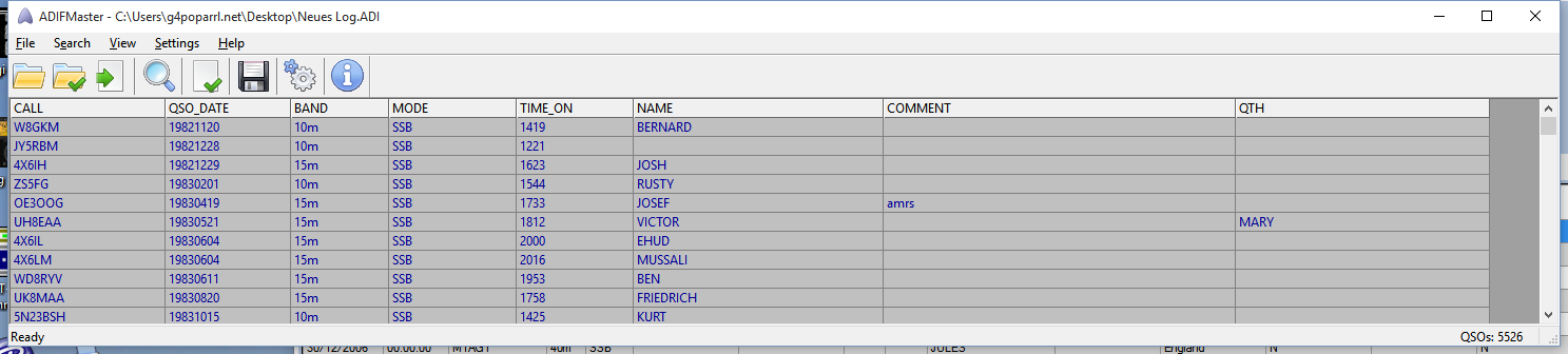

The ADIF file that you sent me contained 5526 QSO's of which 76 were duplicates, see the log text file that I emailed you! (Dulicats are the last 76 entries in the text file)
The ADIF file only has a few fields and did not contain the DXCC number or the DXCC country (See the graphic below from ADIF Master) so during import I checked the update country choice in the ADIF import window and this data was calculated using the call sign prefixes.
Screenshot 2015-10-11 13.07.07.png (43.81 KiB) Viewed 2730 times

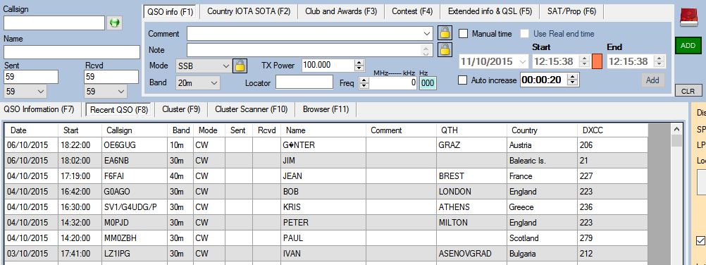

When the file was imported all of the Names and what comments it contained were satisfactorily imported, see Log4OM image below.
However your ADIF file from your old program did not contain and signal reports sent or received (RST) so there was nothing to import to Log4OM.
I have emailed you the import log report and also the Log4OM database that I created from your ADIF file
