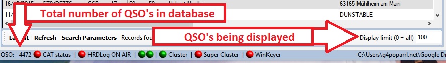

For speed we set the default view to display the last 5000 QSO's but you can change this to any number you like by clicking in the box at the bottom that says "Display limit (0 - ALL) and just type the number that you require to be displayed.
All 32000 of your imported QSO's are in the database its just the number actually being displayed and if you do a search or filter Log4OM will search and filter all 32000 QSO's
Some users with steam powered computers reduce the displayed number to a couple of hundred to speed things up, whereas power computer users will display all the QSO's in the database, its your choice!
