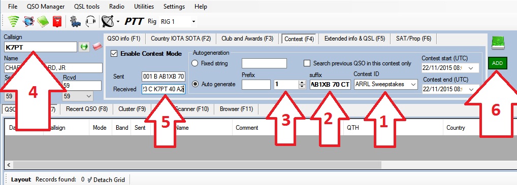

I don't know anything about this contest but checking the contest rules I think you need to do the following
1. Now enable contest mode and select the ARRL SS CW or SS SSB from the drop down list
2. Enter "Precedence" in the 'Suffix' field like 'B AB1XB 70 CT'
3. Set the start serial number
Steps 1, 2 & 3 are only done once until the program is restarted
4. Enter the other stations call sign
5. Enter the other stations exchange details (Received)
6 Click 'Add' or press the enter key on your keyboard to enter the QSO
As shown below
If you want to search previous QSO's for this contest only then check the search box and set the start and end dates
Hope this helps?

Precedence, section and check, if i remember well, are fields in ADIF we support when we load and export QSO back to ADIF, but those fields are editable only in QSO manager. There are no fields for filling those informations in the user interface. At least now.
