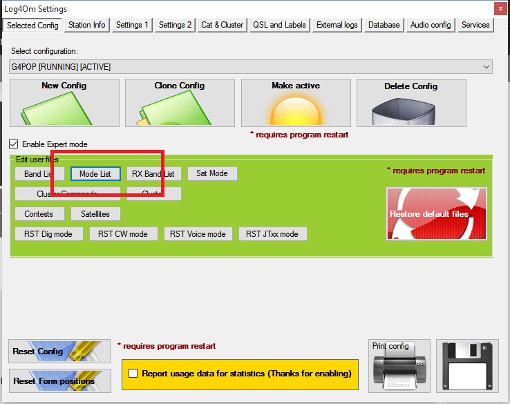

Options/select config - check Enable expert mode - Modify the 'Modes' list

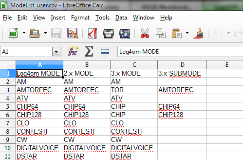

Currently, it is set to be the LibreOffice 5 spreadsheet. On the first press of the mode list button I got an error message and each subsequent press brought up the LibreOffice 5 text import dialogue from which the file would open.
Could you please let me know which program would be best to use to open/edit this .csv and which column is the one or ones to edit? I have attached a small image of that shows this end.

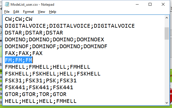

Which column does one edit? I have opened the file with notepad and each mode is listed four times; more often than not each mention is identical to the last.

Re: list of modes
If you want to delete a mode just delete the whole row, example below

Terry, what do I do if I want to add a mode (e.g. FSQ) as not all columns are identical (like the Domino examples in your screenshot)?
>>It's a plain text file any formatting will render it useless.
I just wanted to double-check as you mentioned using Wordpad for editing. Also, Wordpad will add the RTF extension after .csv unless one is careful (I use "s to prevent this).
Regards
Guy
Re: list of modes
The first part is the mode type e.g PSK;
all of the following entries between semi colons are sub modes. So in the example of PSK it has the following different sub modes (Varieties)
FSK31, PSK10, PSK31, PSK63, PSK63F, PSK125, PSK250, PSK500, PSK1000, PSKAM10, PSKAM31, PSKAM50, PSKFEC31, QPSK31, QPSK63, QPSK125, QPSK250, QPSK500
Therefore if FSQ is the main mode definition it could have sub modes as follows:
FSQHF; FSQVHF; FSQUHF; FSQSHF; FSQANYTHING
A mode that has no sub modes could be just G4POP;G4POP;G4POP as in FM;FM;FM or FAX;FAX;FAX
