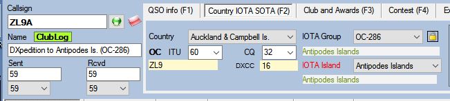

Manolo, if you double click the ZL9A entry in your log 'recent qso' window it will open in edit mode. Click the TAB for 'Country IOTA SOTA' then look for the IOTA Group drop down box. Click the PadLock icon so that the entry box turns yellow, then click the arrow to open the IOTA list and scroll down until you find OC-286 then in the box below that, ('IOTA Island) choose Antipodes, the click on the large Icon 'Save and Exit'.......
