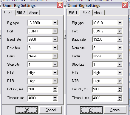

I do not know if this will help at all Stan.... I do not have a IC-718, but do have both the IC-7800 & IC-910 hooked up to Log4om and these are my settings.
regards
John
VK7XX
