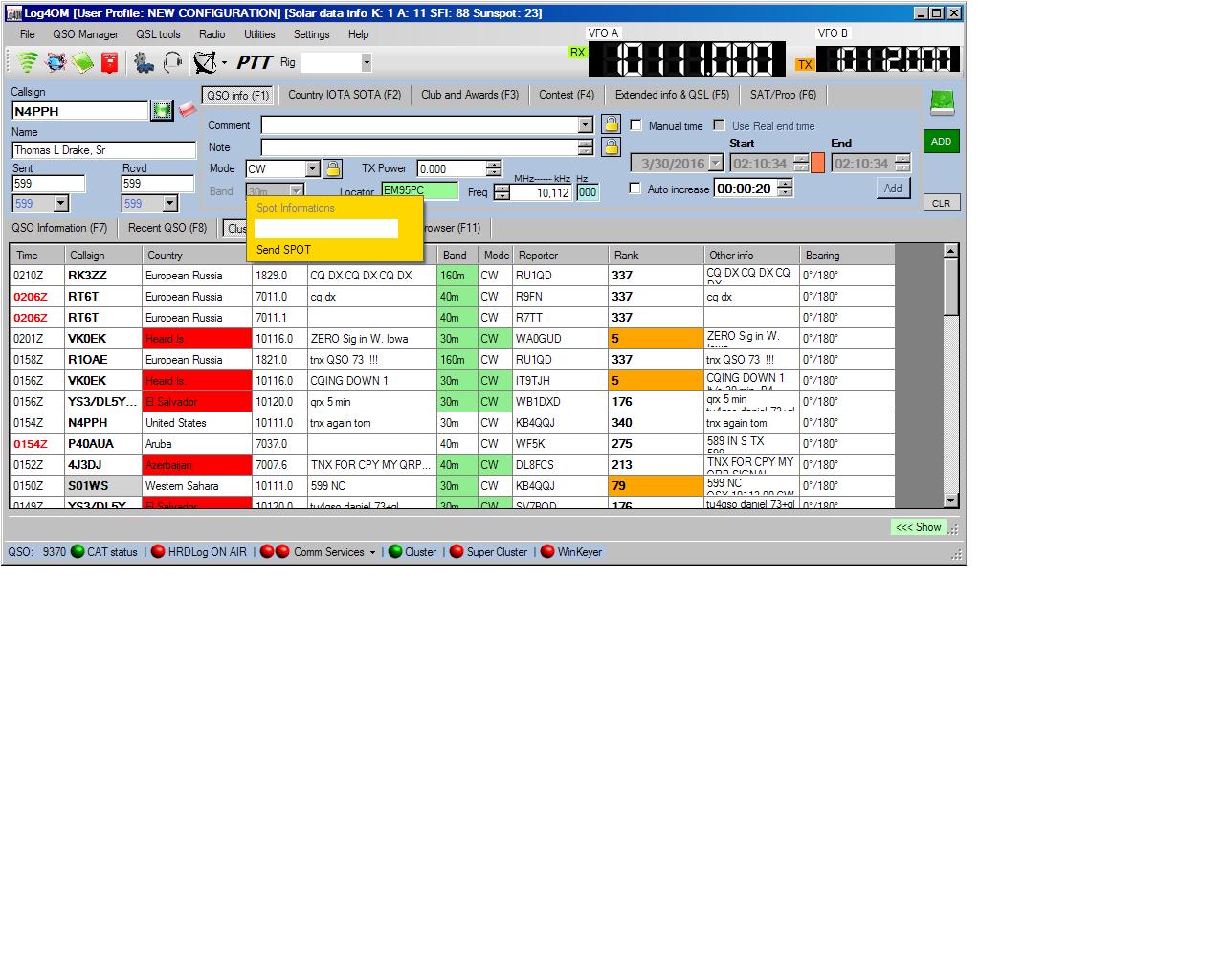

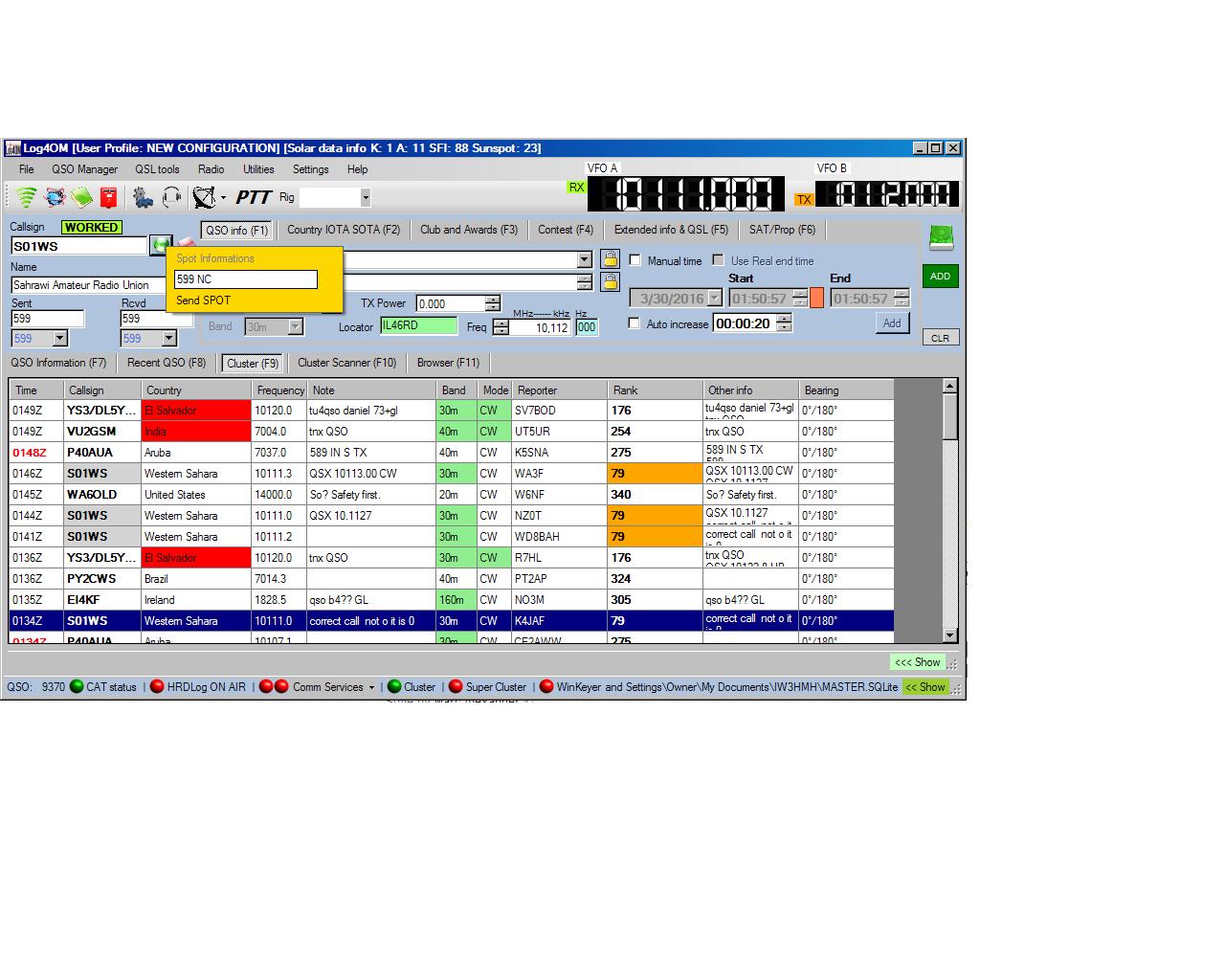

(see photo spot1)
At that point I hit "enter" a second time still trying to save the contact to the log and another spot window pops up in a different place. (see photo spot2)

SPOT 1
SPOT 1
SPOT 2
SPOT 2

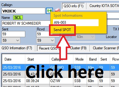

I don't think that you are clicking 'Send spot' as shown below

Hitting 'Enter' is not the way to send the spot - You must click on 'Send spot'
The process should be
1. Click 'Send spot' in the spotting dialog - The spot is sent and spot window closes - QSO details retained for editing or adding to log
2. Now click Add or hit the enter/return button on the keyboard - contact is added to the log -Cursor returns to call sign field ready for the next entry
