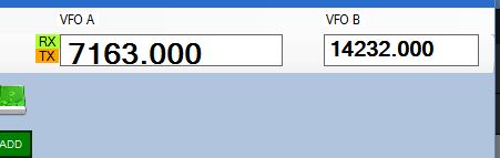

Please use Omnirig latest version and also latest Omnirig rig ini files
Select IC-7100e4 and then you will see both of the 7100 VFO's as the screen clip of my IC7100
