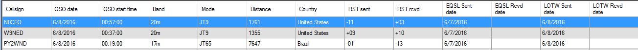

I started noticing Log4OM is logging the wrong QSL upload date for eQSL's. Upload dates for LoTW are correct. See attachment. Compare the QSO date and time to the eQSL sent date.
Note that this error (?) only seems to affect the log, the actual QSL on eQSL.cc has the correct date. A QSL match is possible.
Am I doing something wrong?

Your upload date is probably different to the QSO date because you are updating at some later date manually, it does not effect the validity of the eQSL data because its the QSO date that is important - Not the date it was uploaded

So back to the original issue. Why does it sometimes display an incorrect date for the eQSL upload? The actual eQSL on the web site has the correct QSO date but my log shows the day earlier.
I haven't made any changes to any QSL accounts online and I've made no changes to my Log4OM configuration in months. Running Windows 10 and the latest Log4om.
