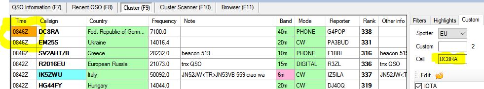

Is the "Custom" tab for the Cluster (F9) the location to develop a file to look for specific callsigns?
If that is the case what would be my nomenclature or verbiage for such?

The custom tab searches the 'Comment' field so of no use if your checking for a call sign
Use the call field perhaps
