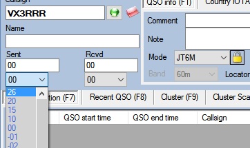

Hallo. I see some problem in default raport in JT6M mode. There is not available standard MS report, 26 for example. When I log QSO, the report is changed to 00. I can not change it. Always is 00, even if I edit QSO and updated, nothing will change. The log is 00. Everything is ok in JT65 mode. Raports are in dB - OK. Pse some help.

I am able to log a JT65M QSO with -26 and it logs fine, or am I missing something in your forum post

Hallo. Yes I see, but your raport is -26 not 26. That is a difference. A small detail HI :D .
So I will be wrote "-" before raport and everything will we ok.

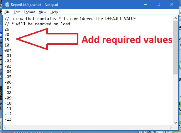

Last Edit: Just I added more raports to file /users/me/AppData/Roaming/LogOM/reportlistJT.txt, now -37 is available.

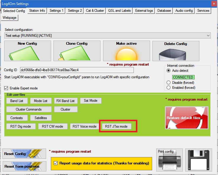

You can modify the RST list yourself as shown in our user guide and videos!
Go to the options window Select config tab and check the box marked 'Enable Expert mode'
Then select button 'RST JTxx Mode' as below
Add the required values to the list and in the 'File' drop down menu click 'save'
Click save on the options window and restart Log4OM
Now you have your values in the list as below
