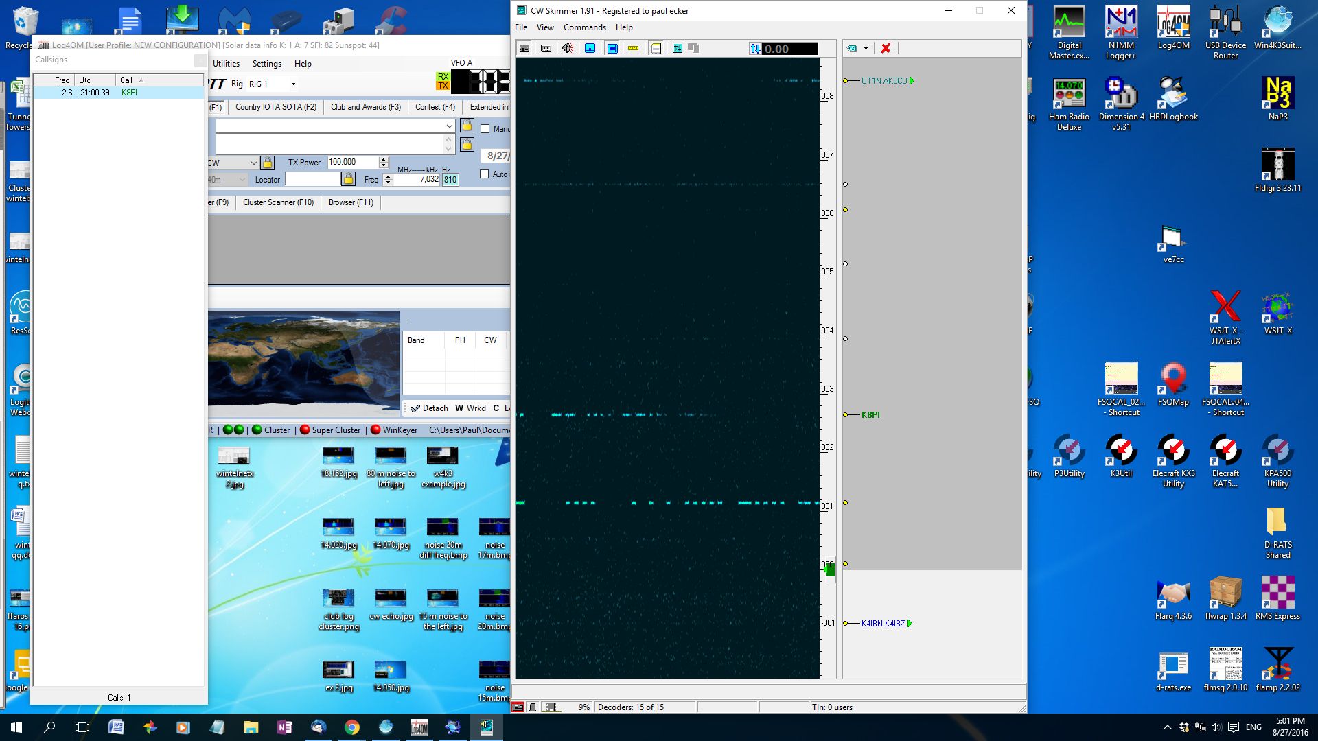

Terry - thanks for the reply. I see that it is working for you, but I can not get it to work as well here. I have screen shots of Omnirig setup, and the Log4om screen but when I tired to attach, it said they were too large. they are about 300kb, don't seem that big. Anyway, I started Log4OM first and the CAT interface open correctly, using Omni-rig Rig1. It shows the correct radio freq. But as you can see in the one attachment I could add, Skimmer opens up but the The Freq is not showing, and the in the lower left hand corner, you can see the radio icon is red, showing that there is a CAT interface problem. If I close Log4OM, and then start Skimmer, the CAT interface in Skimmer works. so for some reason, I still have a conflict it seems. Can yo help?

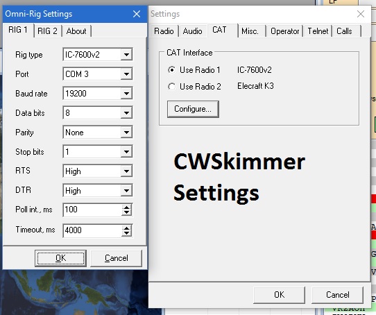

Re: Omni-Rig Question
Is Omnirig Rig 1 connected directly to the radio or are you still using a virtual serial port?
If your still using a VSP - Why?
Did you install Log4OM as an administrator (Run as an administrator)?
What version of Log4OM are you using?
Did you ensure that CW Skimmer is connecting to Radio 1 the same as Log4OM in the CW Skimmer settings/CAT menu?
Is the CW Skimmer settings/Radio tab is using the 3kHz radio?
Are you using the latest version of Omnirig? - Must be version 1.16
Terry- I reinstalled Log4OMJ as an Administrator, and set the properties to always run the program as Administrator. Then tried again still joy - but still using VSP. Then I change the properties on CW Skimmer to always run as an Administrator and voila! it worked - still using the VSP. So I am good to go running both Log4OM and CW Skimmer with a good CAT interface to both & still able to use the VSP. Thanks so much for you help and persistence.
