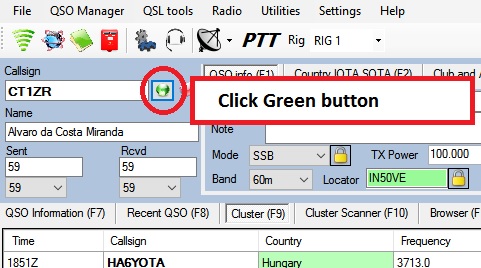

You cant send a spot to the cluster after you have added the QSO, you should send the spot during the QSO, see below

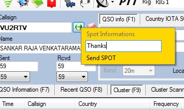

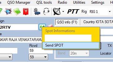

Tried this today, and I do not see my spots posting to the cluster.
Also I see that unless the information box is empty, then the send becomes disbled
Am I missing something.??
- pic 2.jpg (38.03 KiB) Viewed 2704 times
- pic.jpg (33.17 KiB) Viewed 2704 times

i'll check, but probably the cluster itself doesn't echoes the spot back to the sender.
If you open the realtime log from help menu you should see the spot going out... if not, increase log level to DEBUG (from help menu)
Any issue will be reported in the log file
