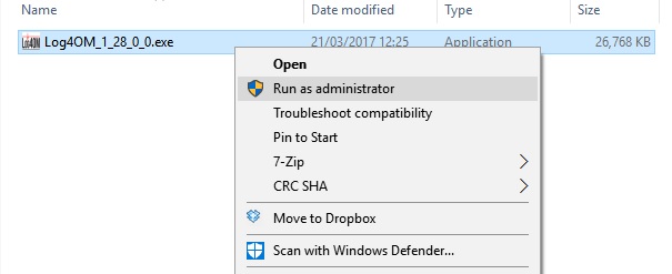

Don't forget it must be installed as 'Run as an Administrator' by right clicking on the installer
Don't go looking for V1.28 its an Alpha test version, the latest is 1.27
