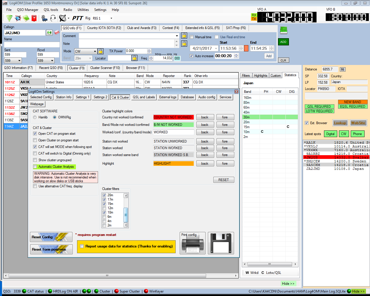

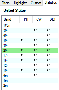

How do I set which bands to include on the Statistics tab when viewing a spot on the F9 Cluster list? I'm missing 17m.
Re: Cluster Statistics list
I would have thought so but what I have selected there is not what is available in my filter listing.
I've restarted more than once.
- Untitled.png (204.7 KiB) Viewed 5413 times
Further testing ...
Those "Cat & Cluster" "Cluster filter" selections do change the available Bands in the drop down on the Filters tab (after save and restart) but are not changing the options on Statistics tab.
Yes. And restarted Log4OM.
My list of Band filters gets updated but not the Statistic list. And my screen shot shows my selection and the rows on the Statistics tab (after saving and restarting Log4OM).
I just did the entire sequence again.
I unchecked 160, in the setup Cat & Cluster. Saved. Shutdown Log4OM and restarted it. The Bands available on the Filter tab no longer have a 160 selection but the Statistic tab still does. Yet you said yours worked?
Mike / KA4CDN
Version 1.27.0.0
Mike / KA4CDN
Version 1.27.0.0
