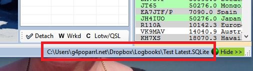

What message does Log4OM display in the lower right hand corner of its main window - See below

It says not connected. I removed log4om and installed the portable version thinnking something from the other version was left behind. If I unstalled and thenm reinstalled the program it would display some error about culture?
. Did initial config of station and launched. It said not connected. Created a new DB. No message eg db created ? Still not connected. When I click on 'not connected' in lower right cvorner it displayed the dialog box shown in pic.

Re: Not connected to any database or database ereror
If you have created a new DB have you connectet to it manually
at the first time ??? Open Log4OM klick on the "File" Menu an klick
on "Open Database" .... In the context menu find your new created
DB ans double klick on it.
After a later new start L4O will connect automatic to those DB ...
