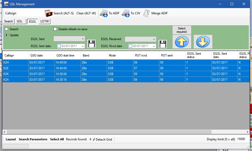

I just imported them into an empty database and all seems OK and I can select them in the QSL Manager after selecting eQSL and clicking search so that they are listed.
However they are all marked as eQSL sent = Y so it seems they have already been uploaded, have you got the auto upload facility activated? If so they were uploaded as you saved each QSO!

Yes I do have auto upload enabled. So "duh" on that part, but I still can't upload just these 4 SSB contacts. I had an FT8 prior to the SSB's and it was selected and uploaded just fine. Since the 4 I sent worked for you, what should I look for on my end as a fault on my end?

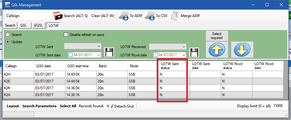

They have been uploaded to eQSL but not to LoTW. I cannot select them for an LoTW upload via the QSL Manager

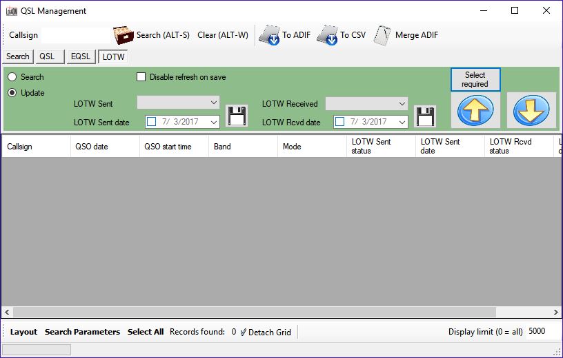

I did. I just tried something a little different in response to your question. In the green panel I selected the Update radio button, which enables the upload/download arrows. Then I selected the 'Search (ALT-S) button at the top. That gave me a list that I was able to select from. I selected those 4 QSO's and was then able to upload them. So now everything is uploaded to LoTW/eQSL & QRZ.
The final question remains though. Why wouldn't the 'Select required' but find those 4 QSO's just as it has been doing for several months now?

Because the QSO's LOTW Sent status is marked N-No not R- requested
