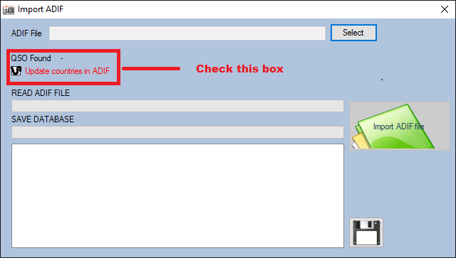

Hello Claudio,
to point 1) Go to Settings/Options/QSL and Labels and turn the QSL Defaults to what you want.
After changing press the Diskette symbol to save the changes ....
to point 2) If you importing an ADIF make shure that the checkbox "Update countries in ADIF" is
checked. For now delete all entries in your log that you have imported and do a fresh import
with this box checked ...
to point 3) First make the changes for the first 2 ponts. Could be possible that the problem in point
3 is solved too ....

About 2) of course I have tried to make "country update" and took a lot of time for 38000 qso...
But I would try to avoid this and I prefer to keep all my DXCC countries as defined in my current logger.
