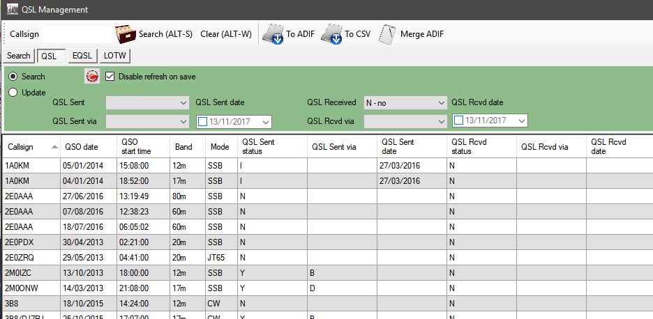

Not wishing to be argumentative but I still believe the thousands of QSL's can be handled easily in Log4OM by perhaps using the QSL Manager as follows

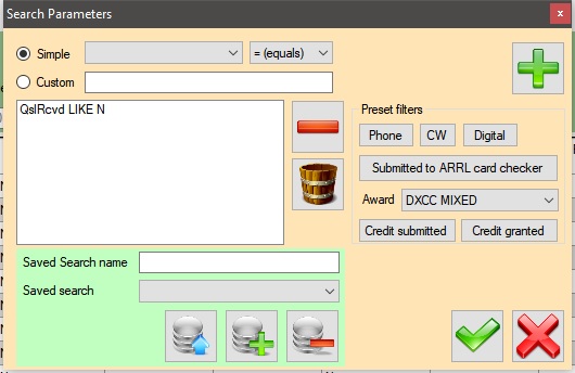

1. Narrow down the number of QSO's to be displayed by using the 'Search Parameters' in the Log4OM QSL Manager window to select just those QSO's that have not received a card QSL received Status is N-no as below
2. Sort the resulting list by call sign - Click the column header title to do that

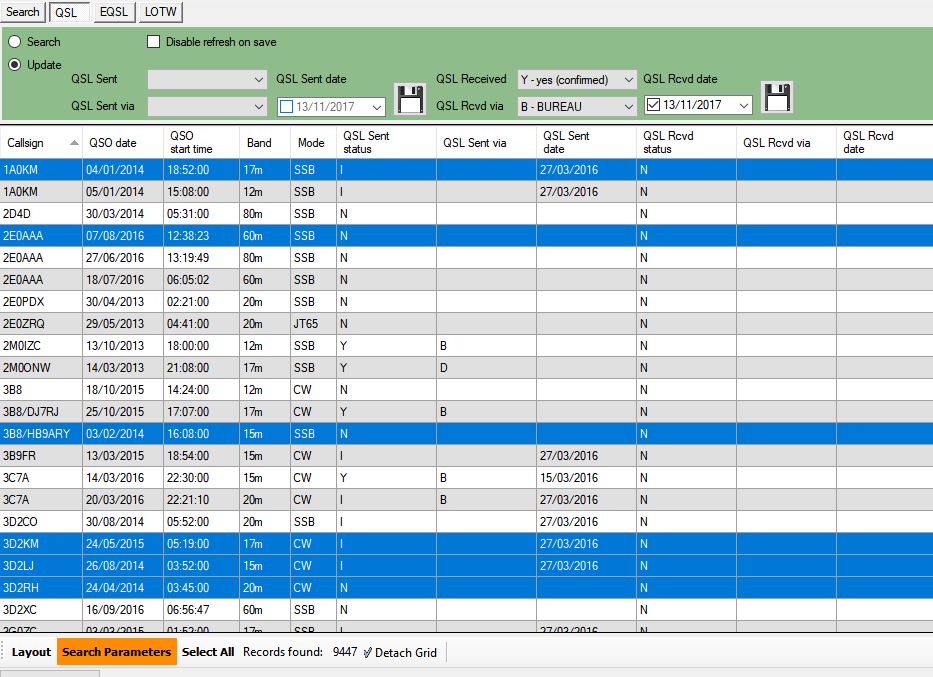

3. Select the QSL Received field to Y-Yes(Confirmed), the QSL Rcvd via to the method by which the cards were received and set the QSL Rcvd date
4. Using the Widows method of Ctrl/Left Click and the scroll feature proceed to select those cards that you already have cards sorted for - Perhaps a batch of 50/100 at a time.
5. Click the small diskette icon alongside the QSL Rcvd date and all the highlighted QSO's will be updated accordingly
Repeat item 3, 4 & 5 until the job is done
