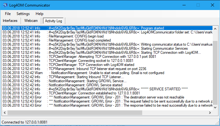

Since upgrading GridTracker to version 1.18.0530, no more log entries are received by Log4OM. I did not change any settings. Log4OM Communicator as well as GridTracker ports are 2236 as they were before. The communicator's activity log is attached. Anybody else having this problem?

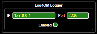

Did you check the GridTracker settings to ensure that not only is the port number correct but also the IP address and that the 'Enable' button is checked?
HB9BRJ
Posts: 174
Joined: 23 Nov 2014, 10:46
Location: Schaffhausen
Re: GridTracker V1.18.0530
Post by HB9BRJ »
Yes I did:
