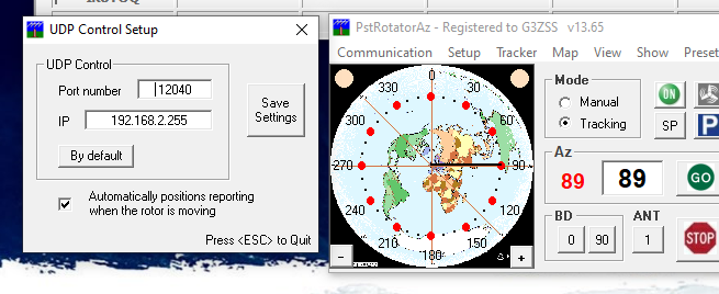

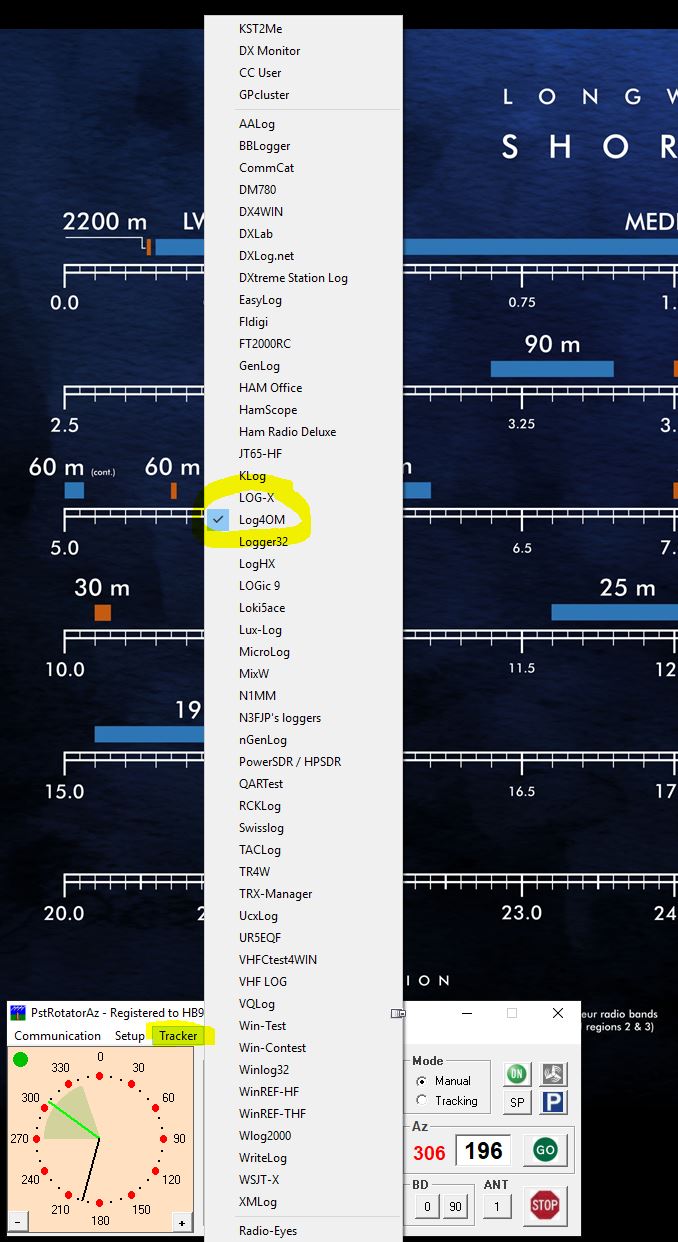

Make sure you have the same UDP port selected between PSTRotator and Log4OM2, as well as "Tracking" turned on in PSTRotator.
It works fine here.

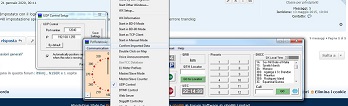

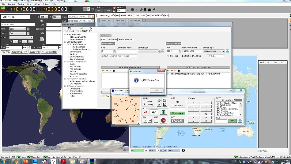

salve a tutti mi da questo error 73.rosario

Is your PST and Log4OM running on the same Computer ?

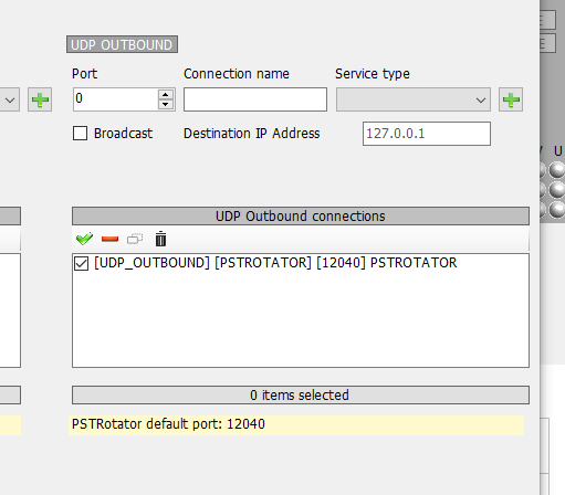

Is there a more detailed setup instruction for setting up PSTRotor I cannot figure out how to enter information or select it, to "fill in" the UDP outbound Connections box.
N8HO
Posts: 32
Joined: 28 Jan 2014, 17:22
Re: pst rotator
Post by N8HO »
Sorry...finally figured it out.

udp 12040 configurato con il log4omv2 settaggi coretti come mi dice log4
set upd 12040 spunto setup udp control tracker spunto log4om ,appena trancking ,mi dice log4om tranckig error
