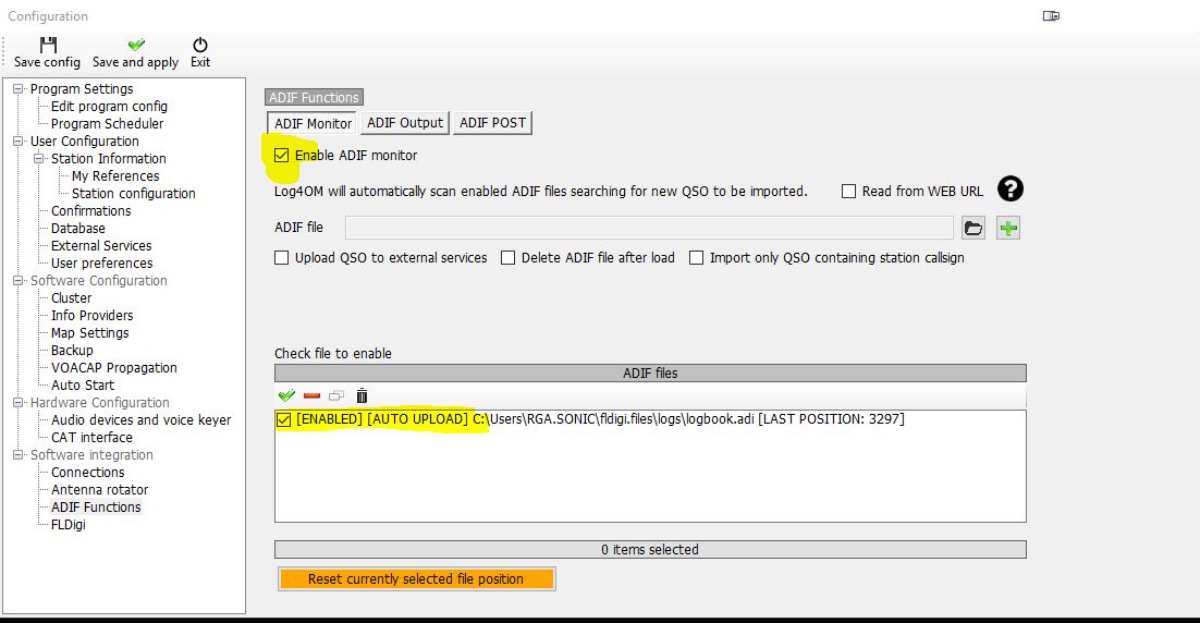

Upload to external services from ADIF monitor stopped working yesterday. QSOs from FLDigi and WSJT-X are coming in and being saved in the L4OM2 DB ok, but won't get uploaded to e.g. QRZ, Clublog etc automatically. Manual upload from the QSL Manager works ok.
QSOs entered directly into L4OM2 are uploaded automatically as normal.
I discovered that the option "Upload QSO to external services" was unchecked. Tried checking it, but once I save & apply, then re-enter the Settings, it's reverted to unchecked.
Tried reverting to my initial config set (cloned straight after install) and reentered the ADIF and external services settings, but the same happens: the Upload QSO won't stay checked.
Please let me know if you need any other info.
Thanks & 73
Tim 4X1ST

Deleted the existing log files in ADIF Functions. Re-entered them, set Enable ADIF Monitor and Upload QSO to External Services. After save & apply, I go back into Settings > ADIF Functions - Upload QSO is no longer set :roll:

Yes, but if you look at the command string it says AUTO UPLOAD. I said the same thing hihi.

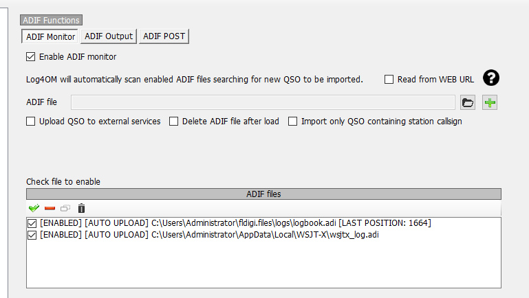

Tim, you have to obey the correct sequence while configuring it.
1.) Mark checkbox "Enable ADIF monitor"
2.) Select Adif File
3.) Mark checkbox "Upload QSO to external services"
4.) Click on green cross icon
5.) Make sure selected path and [AUTO UPLOAD] appears in the bottom section "ADIF files"
Hope this helps.
Roland

I followed the sequence you described, and did save & apply. When I go back into the config, the "Upload QSO to external" is again unchecked, but I do have the [AUTO UPLOAD] against each file. I will be able to check the upload tomorrow.

Thanks Tim, just wanna make sure are you running Log4OM V2.2.0.0 ?
The "Auto upload" is actually the setting "Upload QSO to external services". So you are all set.
