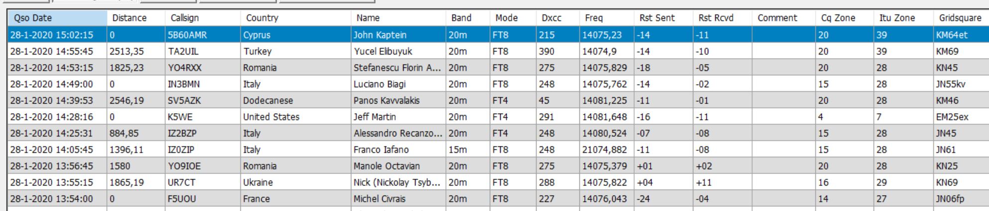

Another issue: When the DX station is using a gridsquare with more then 4 characters, Log4OM2 cannot calculate the QRB

K5WE in EM25ex on 20m FT8
No Distance report (0)
only wsjt-x and log4om2

PA0AER wrote: 28 Jan 2020, 14:45 K5WE in EM25ex on 20m FT8
Strange it works fine for me with both WSJT and JTDX
