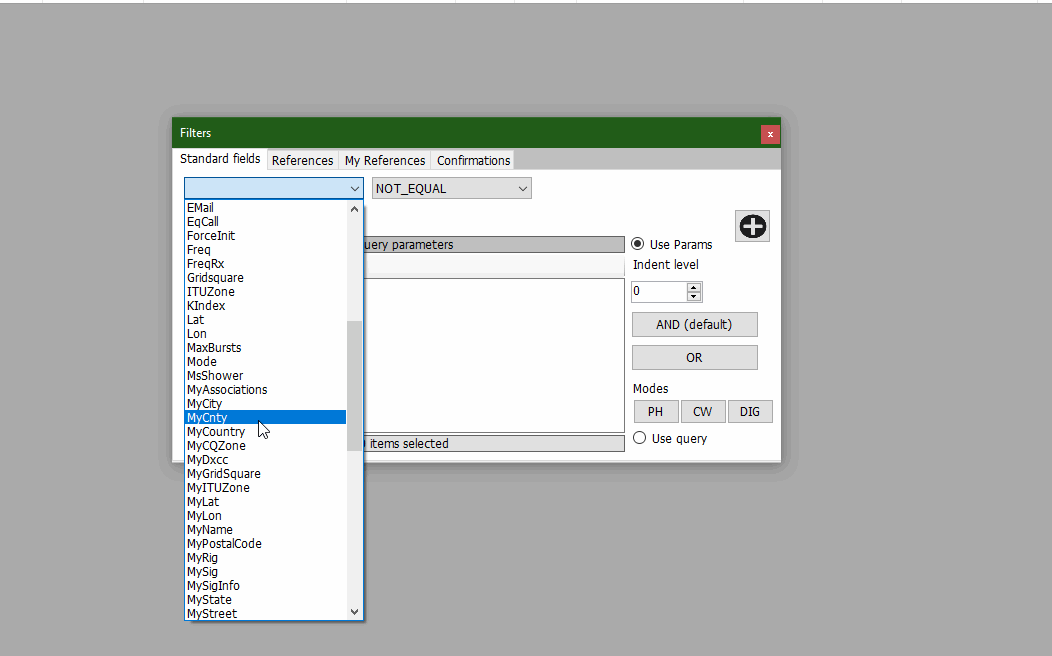

EDIT.. I am trying this
And also in your last post I thought you were referring to below.
And I expected to find LOTW in here but did not.

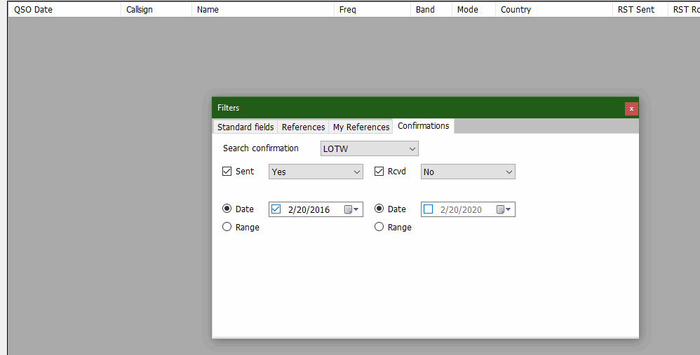

Re: Unconfirmed filter
Terry,
No records after applying this.
Which window are you using the filter in
Do you realise the filter does not action until you close the filter window?
Currently trying it in the recent QSO window.
And yes I am closing the window.

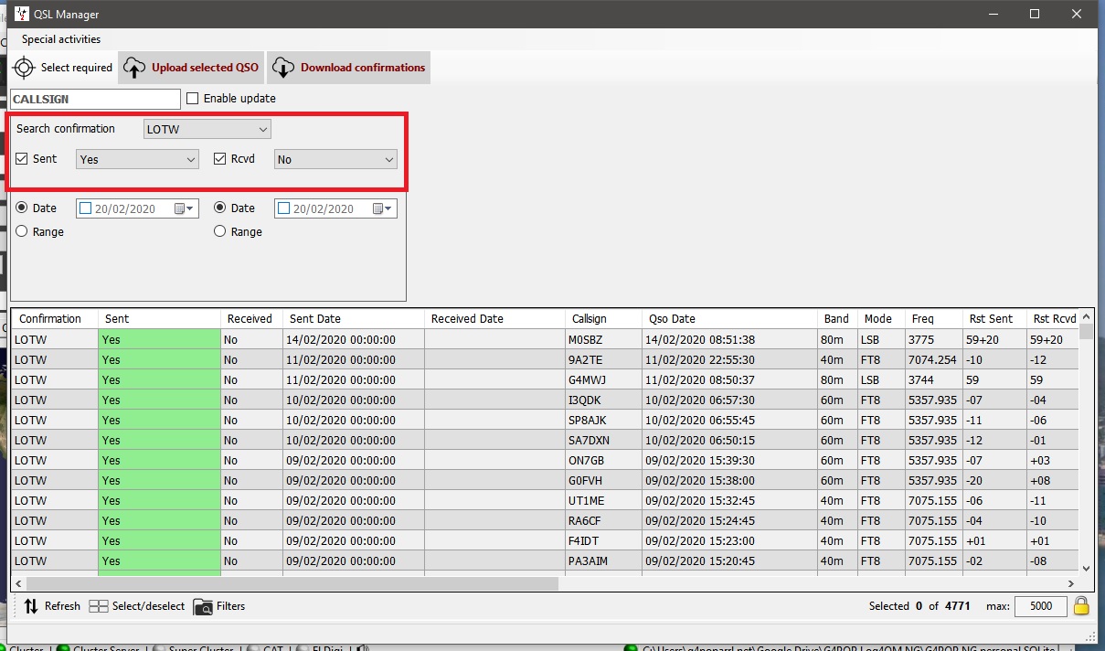

Use the QSLmanager Window for this filter ..... It´s not a field to search for in recent QSO tab ....

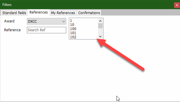

Still do not know how to filter this to DX only.
And I do not understand References and My References. What is different.
