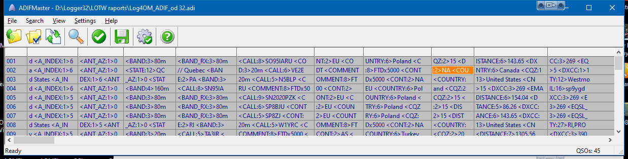

can not open adif file exported by L4OM, and after import L4OM adif looks like quite diffrent format against a normal from other programs.
And a question HOW to get a normal adif from L4OM?

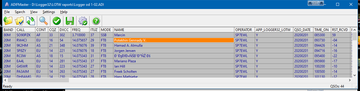

- Zrzut ekranu 2020-02-23 17.51.53.png (51.24 KiB) Viewed 6241 times
- Zrzut ekranu 2020-02-23 17.52.24.png (60.27 KiB) Viewed 6241 times

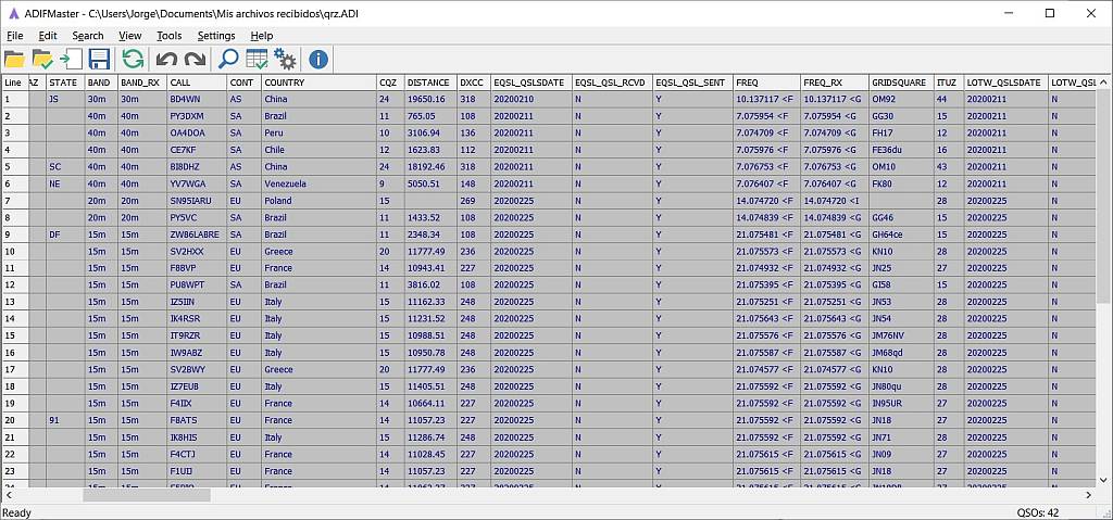

Hi Zbig,sounds like a problem in your export,maybe a Windows admin privileges issue ? You tried to export to another folder or unit ?
I can export adif files without problems, Adifmaster opens them correctly, and, in fact I export them to qrz.com.
I attach a newly exported adif
73 Jorge

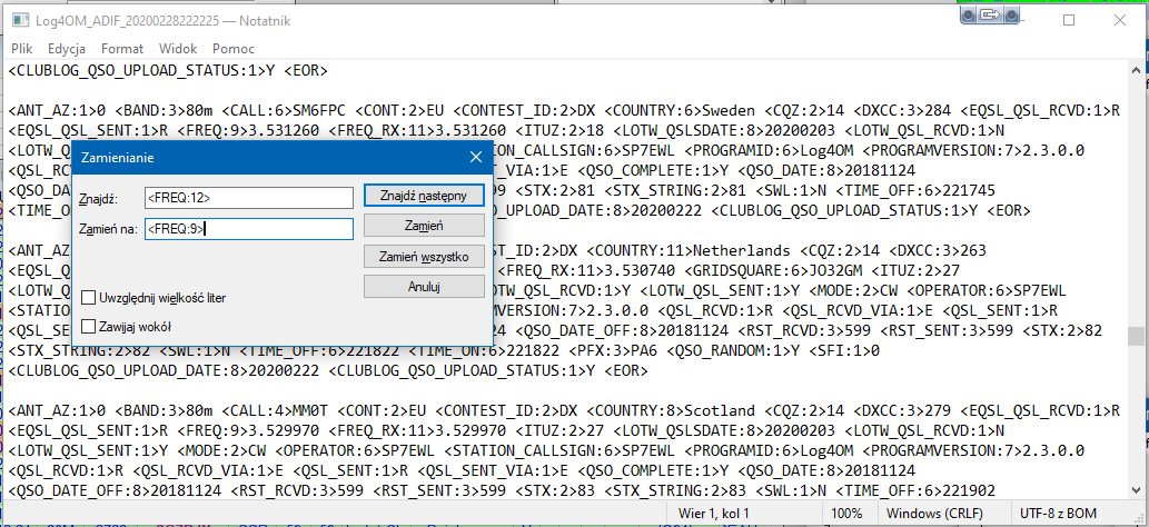

I found at exported from L4OM adif file a difrent lenght of data in field <Field:L>data
where L is a lenght of data and at L4OM this lenght is 12 however is use only lenght 9
<FREQ:12>14.075417
wsjt log and Logger32 adi this field is designed for lenght of 9
wsjtx log - <freq:9>14.075417
and Logger32 adi field is the same as wsjtx log - <FREQ:9>14.075417
So, I think this is a reason of error during import from L4OM to Logger32

Success, I changed the entire adi file from L4OM data field length from 12 to 9 and I imported this file to Logger32 without any errors
As in the attached screenshot
Vy 73 Zbig SP7EWL
