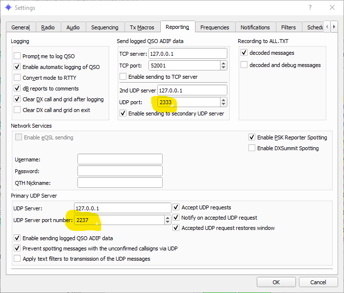

I think there is an error on page 146 (Connecting direct to JTDX) of the current Log4OM User Guide:
  • Both primary and secondary UDP ports are displayed as 2333. One of them should be 2237.
This is what works for me:
JTDX Reporting.png (46.36 KiB) Viewed 5272 times
Charlie -- K5EY

Re: User Guide Error - Connecting direct to JTDX
Thanks for spotting that, I have corrected it and will upload later.
At least the text was correct!
Updated and ready for download

When set as below, everything works without any problems.
Primary Port UDP - 2233
Secondary Port UDP - 2237
sq9jxb wrote: 24 Feb 2020, 13:18 Hello
Jan,
Over the past many months of testing I've tried those ports as well and (as you have noted) they work well.
Part of the joys of ham radio are the options and variables that we can each come up with to make things work best for our stations.
We try to settle on a group of settings that we have tested and find that work for most situations. Ergo ... what we have in the User Guide and (goes without saying) that it can be subject to change based upon APP changes from the other providers as well. Can be a moving target many times.
Thanks for you sharing and input.
