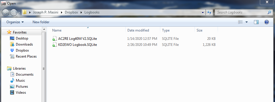

Here is what is in my Drop Box:
The new database base file is the AC2RE one
The old File is the KD2EWO which has all my QSOs sine I have been licensed, and used by Log40m.
Is there an ADIF file somewhere? Or can I create one from the old program? When I search my computer there is no ADIF files.
Thanks Terry

Re: SQLte to ADIF
As I already said FILE/EXPORT ADIF

Re: SQLte to ADIF
The ADIF File was in my Fldigi log files. (Fldigi.files/logs)
I tried to import the files but said database not good.
I then deleted the database I created for V2
I then created a new database in V2 and imported the files.
It all worked and up loaded.

Re: SQLte to ADIF
The recommended route (in the Manual!) is to run Log4OM V1, then from within V1 - EXPORT your entire V1 QSO log to an Adif file. Then import that file into V2, after creating a new log file in V2.
