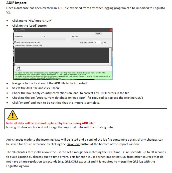

Did you use the Apply country corrections on load option? The image below is from the current version of the User Guide on Page 16.

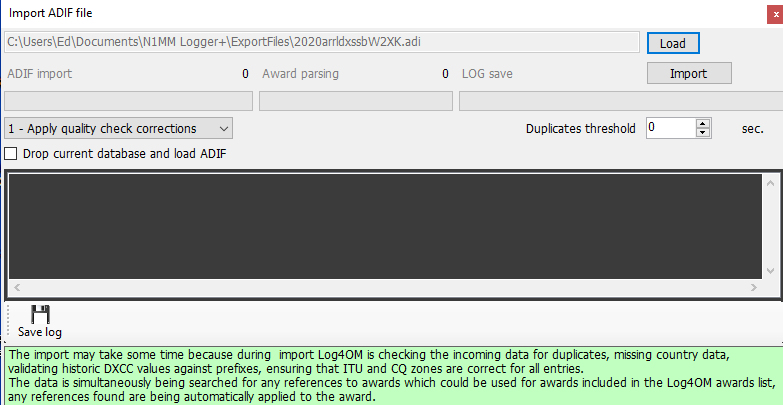

No, there is no checkbox for that. The only checkbox available is to drop the current database.
import image.jpg (201.91 KiB) Viewed 6132 times
Using v2.4.0.0

Did you look at the N1MM Contest Logger Integration? It is noted on Page 158 of the most current User Guide.

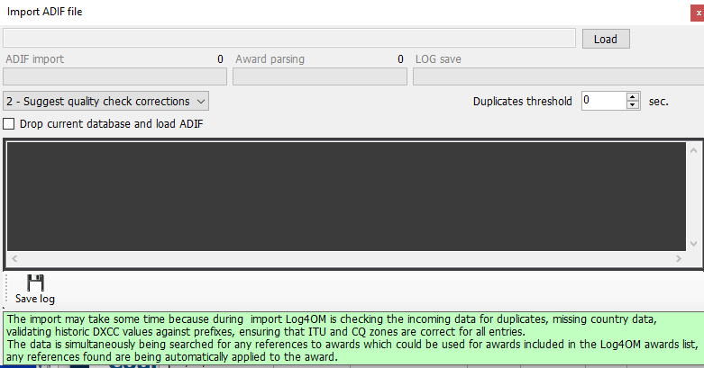

Here is the same screen with the adif "loaded". I still do not see a checkbox to update countries.
Posts: 11618
Re: Countries NOT imported/updated when importing log from n1mm
Forget the check box it was changed to a drop down a short while ago and option 1 from the drop down does what you require

Yes, I see the dropdown box, but the countries were NOT added/updated when I imported the log.
So how do I get the countries updated for the hundreds of entries that are now in log4om with no country listed?
G4POP wrote: 09 Mar 2020, 15:43 Forget the check box it was changed to a drop down a short while ago and option 1 from the drop down does what you require
