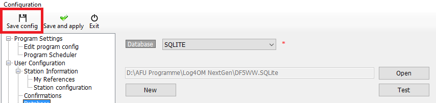

Have you saved the configuration after you created the new DB and imported the ADIF ?
If not Log4OM can´t know it at the next start.

F4VRF wrote: 17 Mar 2020, 16:08 When installing the program I went through the create database steps and was told that a database was created and connecting correctly!!
O.k., looks like you have an active database connected. This should be shown in the right lower
corner of the Main UI. See my screenshot:
If you see this you are connected to a valid database and if you don´t see any entry in the
Recent QSO´s (F7) tab it´s only empty. All you have to do then is to import ADIF via the
File menu in the upper left. By the wy it must be an ADIF in ADIF3 format. If you have
Log4OM V1 installed you can export in there an ADIF as ADIF 3 (see the checkbox in the V1
export window).
