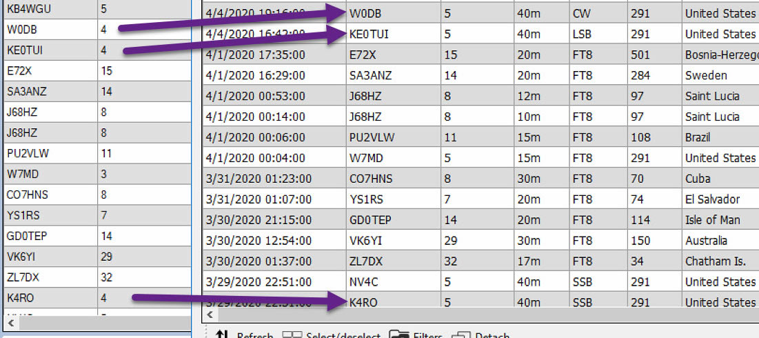

The plot thickens...
So I exported my log to a CSV file. I added LOTW QSL received and CQZ before exporting.
I started to sort all that out and it appears all my CQ zone 4 contacts are VEs and all my US contacts are lumped into Zone 5.
After sorting the CSV file there are only 50 LOTW confirmed contacts in Zone 4 and none of them are on 15.
So not a JTalert issue.

As a test I backed up and deleted my Log4OM log and imported QRZ ADIF file which had 1,956 instances of CQ zone 4 contacts in it.
When done Log4OM is still showing them as Zone 5 !

When I import into Version 1 I get zone zone 4 and when I import same ADIF into version 2 it shows zone 5.
I have not checked very far but there is certainly a lot more zone 4s in Version 1.
