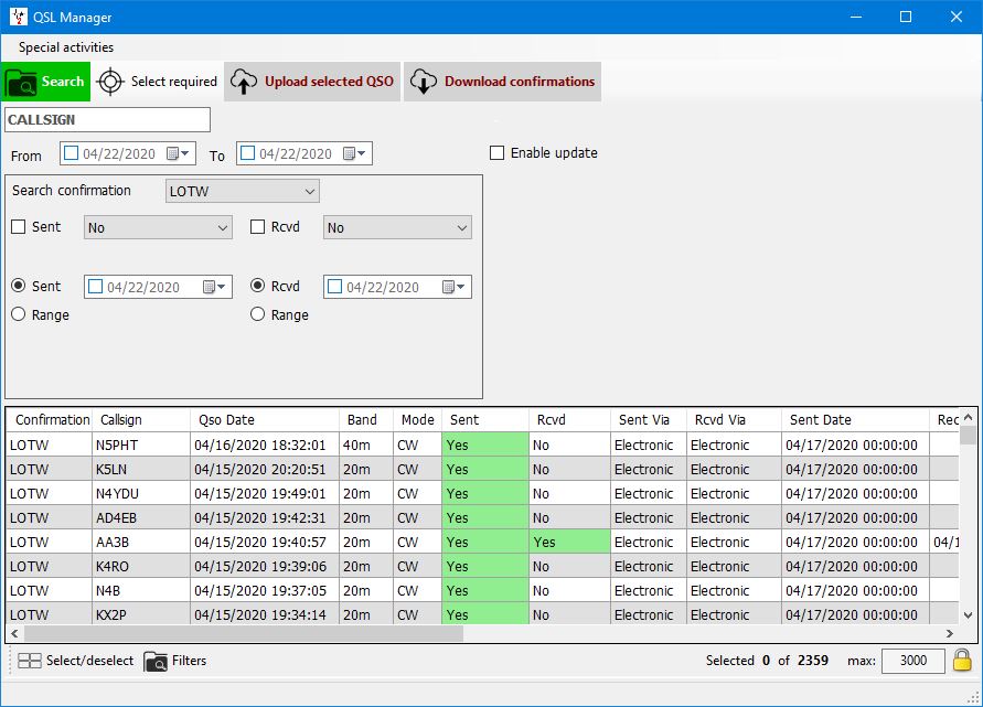

Bob,WA2SQQ wrote: 22 Apr 2020, 01:30 LOTW not working. When I select it, he list does not refresh and I can't upload new contacts
I'm going to make some assumptions here as you have not given a lot of information ... so here goes:
Have you updated your TQSL to the new release of v 2.5.3 that LOTW has released?
Have you updated your Log4OM V2 to V 2.5.0.0 ? Go to "Help / About" to confirm which release of Log4OM V2 you have installed.
I will assume you have then also updated Log4OM to V 2.5.0.0
I will also assume that you have opened the QSL Manager and have selected LOTW in the Search Confirmation window.
Once you do that you have to tap the green search button and your list of LOTW QSO's will appear.
Once that list is in place you then tap the "Select required" button which will then make the selection process for the Q's you can then upload to LOTW.
Again ... this applies to the new release of V2 and (as I have commented in an FAQ on this Forum) you need to make it a habit to download the V2 User Guide with regularity.
If you look at the "current" User Guide the information about the QSL Manager and "QSO manual upload to online logs" is located on Page 79.
Below is a screen clip of my QSL Manager after I've done what I noted for you above. All of which is in the User Guide.
- QSL-Manager.JPG (109.12 KiB) Viewed 5857 times
