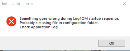

following the installation of the last version, a message is displayed during the execution of the program.
Something goes wrong during Log4OM startup sequence. Probably a missing file in configuration folder.
Check application log.
The message is displayed since the update. (2.4.0.0 to 2.5.0.0)

It would really help if you posted a screenshot of the message here, we don't have a clue what it says otherwise!
Re: 2.5.0.0 - Something goes wrong during Log4OM startup sequence
You will find attached to the message the screenshot of the error message .
I made a video but impossible to load it (2mo)
Have a good day.
73 Christian
Have a good day.
73 Christian
