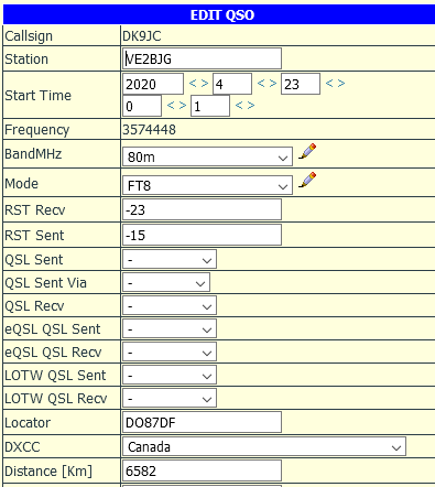

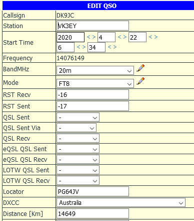

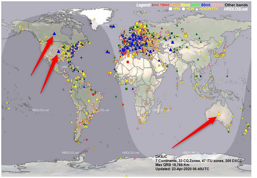

Today when I saw my HRDLog map I wondered about the new markers, which are not set correct as they are in the center of the DXCC:
I went into the details of the HRDLog logbook and saw that the locator does not match the one stored in Log4OM.
Im my Log4OM I have FN46 stored (from WSJT-X):
Im my Log4OM I have QF23 stored (from WSJT-X):
