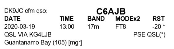

I printed a label for C6AJB.
QSL is via his homecall KG4LJB, which is continetal US, and not Guantanamo Bay as printed on the label.
Guantanamo Bay are only 2x2 calls, e.g. KG4NE.
2x1 and 2x3 are regual stateside.

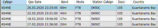

I saw this thread, but is my problem not a different one? When I work Gitmo I know how to change the Country Name.
But here the name of the DXCC comes automaticalls on my label if the manager has a stateside call beginning with "KG4". Not sure how the other topic can help me here.
My gitmo QSOs are correct btw, and the label was OK.

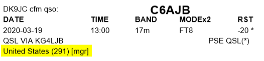

DF5WW wrote: 27 Apr 2020, 10:31 please download the latest country file (updatetd) via the Settings/Update resources menu
and try again.
It worked now. I can confirm that my problem is fixed. Thank you! :shock:
