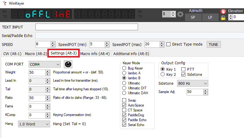

I use FTDX-101D via the back of the radio, I use the output for CW Key and use cable usb cw cable this COM10.
I don't find the settings in WinKeyer always get notification time out.
73 Pat

For setting in Winkeyer open the winkeyer window and use Settings (F3) ...

ON3CQ wrote: 30 Apr 2020, 09:01Info.jpgInfo.jpg
No!
What HARDWARE WINKEYER are you using
Original K1EL serial or usb Winkeyer

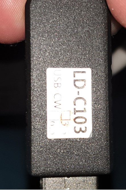

I use this one
Re: WinKeyer
ON3CQ wrote: 01 May 2020, 13:39 Hello Terry,
That is not a Winkeyer and it will not work with the Winkeyer interface in Log4om v1 or v2
