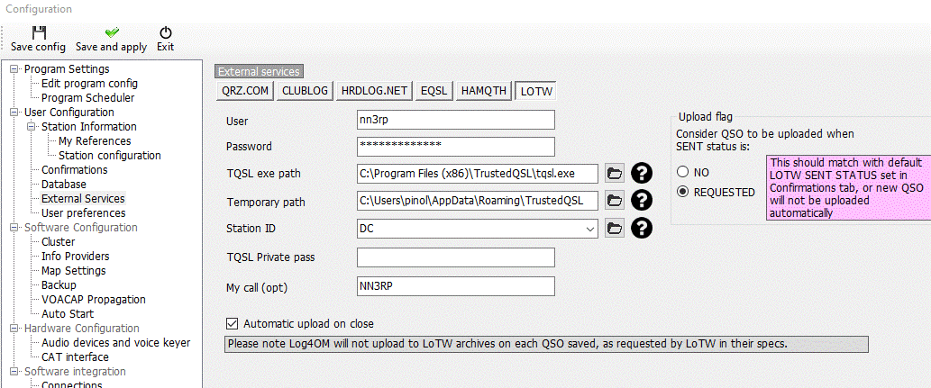

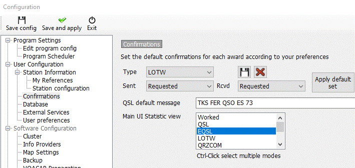

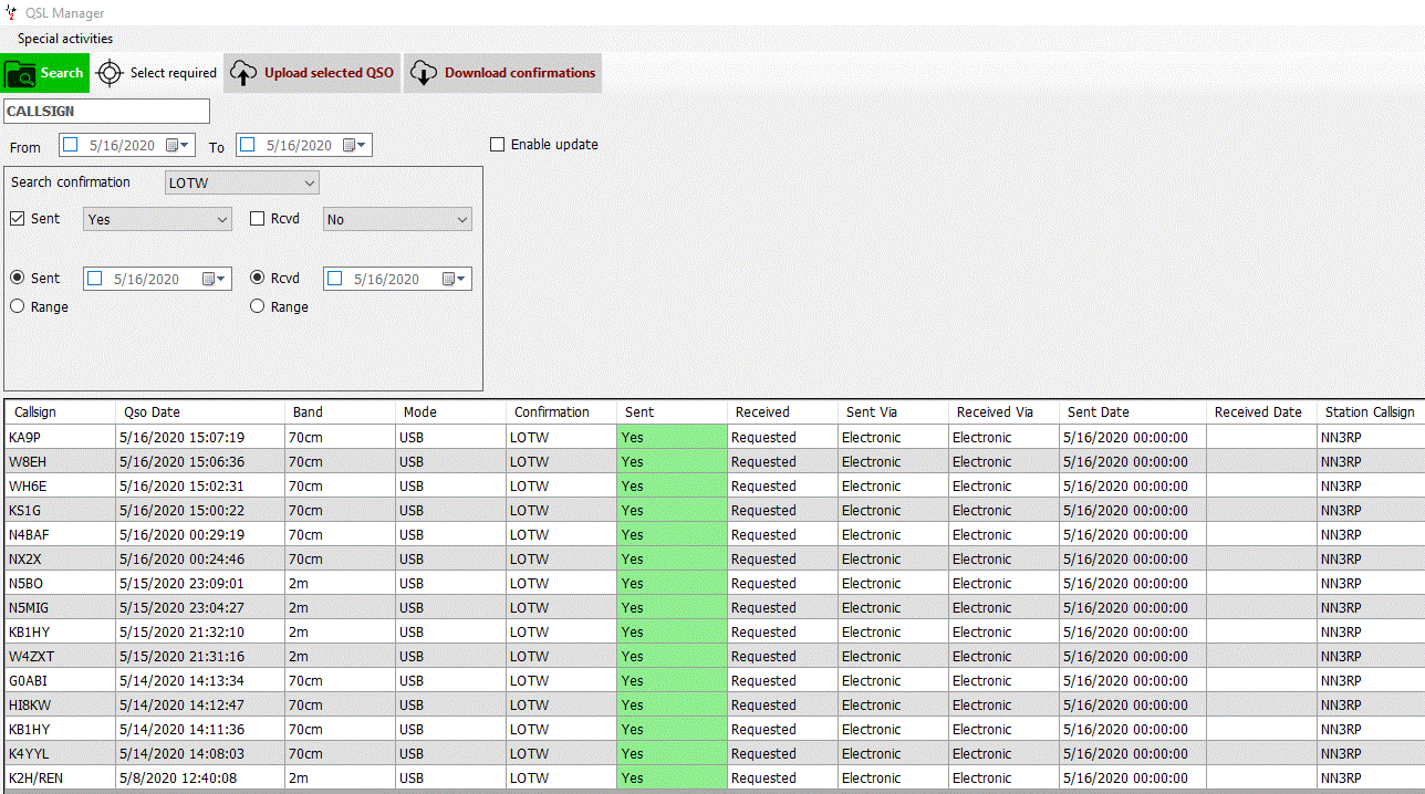

I am new at this wonderful Log40M software but I am having an issue with LotW. Mainly is that although the manual upload takes place (automatic after closing program does not work), I am not able to see the uploaded QSOs at the lotw website. My Log40M settings are Ok, I believe. Here are some snapshots:

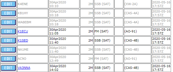

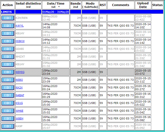

Also, on another note, I just check the eQSL and, although the upload is there, they are not listed as Satellite:
Here is another eqsl picture that I just uploaded with recent satellite QSOs from TQSL software. Notice the (SAT) entry:

I wanted to update this post with my troubleshooting. I think I nailed it to be the Station ID not being there initially. I mostly think that I did not have the password correct too. Once one has the correct LotW account setup (user, password, tqsl path, temp path), Log40M allows to use the Station ID pulldown. In there you will see all of the LotW ID you have under your Tqsl software.
I did a test log and quit Log40M....after a few minutes my test log appeared on LotW website!
