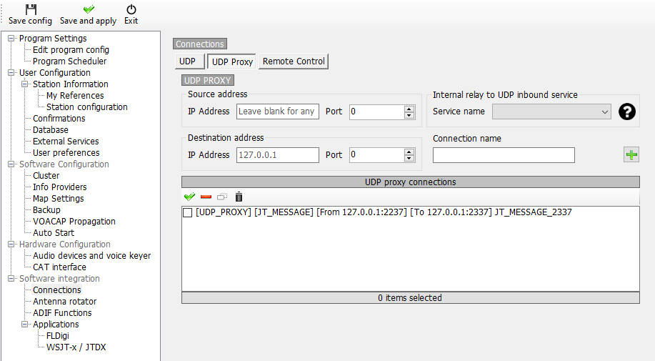

I configured UDP Proxy connection:
[ ] [UPD Proxy][JT_MESSAGE][From 127.0.0.1:2237][To 127.0.0.1:42237] JT_PROXY_4
Problem:
Not receiving any packets on port 42237. In the config file the "Enable" is set to false. Tried to edit config manually - setting it to true does not help, Log4OM2 changes it back to false.
Not sure what I'm doing wrong here...

Here is my config:
Code: Select all
          "Enabled": false,
          "Name": "JT_PROXY_4",
          "NetworkConnectionType": 5,
          "NetworkInboundMessageType": 3,
          "NetworkOutboundMessageType": 0,
          "DefaultAnswer": "",
          "SourceAddress": "127.0.0.1",
          "SourcePort": 2237,
          "TargetAddress": "127.0.0.1",
          "TargetPort": 42237,
          "Broadcast": false

Could you please post a screenshot of your Proxy settings in Log4OM. Will try to replicate your issue.

Tested with shorter port number, did not help.
Setting screenshot attached:
73, Piotr KD9NHZ
