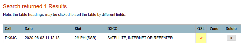

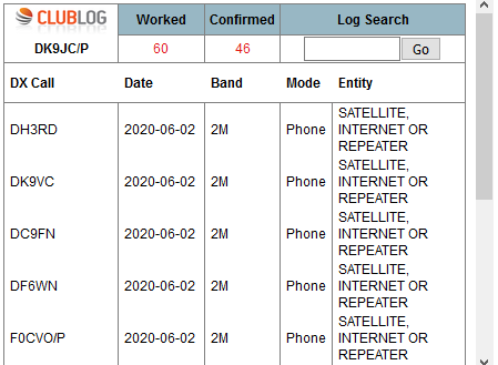

Yesterday I was outside and did 2m SSB/FM from a SOTA-Summit. I logged on paper and entered it all into Log4OM v2.6.1.0 afterwards.
It looks like this on clublog with "SATELLITE, INTERNET OR REPEATER" shown as mode:
Clublog 2020-06-03_11h07_09.png (18.66 KiB) Viewed 6074 times
I did some investigation in the log. No submode is ticked. The only thing I see is that there is no RX QRG entered and it is shown as "0".

Here is an ADIF-Export of one of the QSO. You can see that Band RX is 10m. I guess this is the problem:
<ADDRESS:16>Frouard
France <A_INDEX:1>6 <ANT_AZ:3>219 <ANT_EL:1>0 <BAND:2>2m <BAND_RX:3>10m <CALL:7>F0CVO/P <CONT:2>EU <COUNTRY:6>France <CQZ:2>14 <DISTANCE:6>106.74 <DXCC:3>227 <EQSL_QSLSDATE:8>20200602 <EQSL_QSL_RCVD:1>R <EQSL_QSL_SENT:1>Y <FREQ:10>144.275000 <GRIDSQUARE:6>JN38br <ITUZ:2>27 <LOTW_QSLSDATE:8>20200602 <LOTW_QSL_RCVD:1>R <LOTW_QSL_SENT:1>Y <MODE:3>SSB <MY_COUNTRY:24>Fed. Republic of Germany <MY_CQ_ZONE:2>14 <MY_DXCC:3>230 <MY_GRIDSQUARE:6>JN39ml <MY_ITU_ZONE:2>28 <MY_RIG:12>ICOM IC-7300 <NAME:14>Jérémy Escrich <OPERATOR:5>DK9JC <OWNER_CALLSIGN:5>DK9JC <STATION_CALLSIGN:7>DK9JC/P <PROGRAMID:7>LOG4OM2 <PROGRAMVERSION:7>2.6.1.0 <QSLMSG:30>TU for the QSO. LOTW uploaded. <QSL_RCVD:1>R <QSL_RCVD_VIA:1>E <QSL_SENT:1>N <QSL_SENT_VIA:1>E <QSO_COMPLETE:1>Y <QSO_DATE:8>20200602 <QSO_DATE_OFF:8>20200602 <QTH:7>Frouard <RST_RCVD:2>59 <RST_SENT:2>56 <SWL:1>N <TIME_OFF:6>175331 <TIME_ON:6>175230 <TX_PWR:3>100 <K_INDEX:1>2 <LAT:7>48.7292 <LON:5>6.125 <MY_LAT:7>49.4792 <MY_LON:6>7.0417 <MY_ANTENNA:28>EFHW Mag Loop Outbacker-1899 <QSO_RANDOM:1>Y <SFI:2>69 <CLUBLOG_QSO_UPLOAD_DATE:8>20200602 <CLUBLOG_QSO_UPLOAD_STATUS:1>Y <MY_SOTA_REF:9>DM/SR-012 <APP_L4ONG_SATELLITE_QSO:1>N <APP_L4ONG_CONTEST:1>N <APP_L4ONG_QSO_CONFIRMATIONS:614>[{"CT":"EQSL","S":"Yes","R":"Requested","SV":"Electronic","RV":"Electronic","SD":"2020-06-02T00:00:00Z"},{"CT":"LOTW","S":"Yes","R":"Requested","SV":"Electronic","RV":"Electronic","SD":"2020-06-02T00:00:00Z"},{"CT":"QRZCOM","S":"Requested","R":"No","SV":"Electronic","RV":"Electronic"},{"CT":"HAMQTH","S":"Requested","R":"No","SV":"Electronic","RV":"Electronic"},{"CT":"HRDLOG","S":"Requested","R":"No","SV":"Electronic","RV":"Electronic"},{"CT":"CLUBLOG","S":"Yes","R":"No","SV":"Electronic","RV":"Electronic","SD":"2020-06-02T00:00:00Z"},{"CT":"QSL","S":"No","R":"Requested","SV":"Electronic","RV":"Electronic"}] <APP_L4ONG_QSO_AWARD_REFERENCES:172>[{"AC":"CDM","R":"F*","SUB":[],"GRA":[]},{"AC":"DXCC","R":"227","G":"EU","SUB":[],"GRA":[]},{"AC":"WAC","R":"EU","SUB":[],"GRA":[]},{"AC":"WAZ","R":"14","SUB":[],"GRA":[]}] <APP_L4ONG_MY_AWARD_REFERENCES:95>[{"AC":"SOTA","R":"DM/SR-012","G":"Germany (Low Mountains)","SG":"Saarland","SUB":[],"GRA":[]}] <EOR>
I wonder what the issue is here and where the 10m comes from. "Band RX" was not filled out during entering the QSO. The field was just blank.

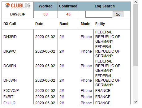

I could not resist to do some further investigation.
I deleted all the wrong entries in Clublog and exported a manual ADIF from Log4OM.
I then deleted <BAND_RX:3>10m in all ADIF entries and did a manual upload.
All is fine then:
