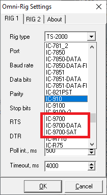

Hi Dave,
if you download the latest RIG files for Omnirig you´ll find the IC-9700 in the Dropdown.
Don´t use 2 Transceiver at the moment so the second one needs a bit more time to arrive

By the way, if anybody use Omnirig, it´s easy to implementing "not seen transceivers" if you check
out Omnirig page. Download the latest rig file unpack it and copy it to the RIG folder of your Omnirig
installation.
