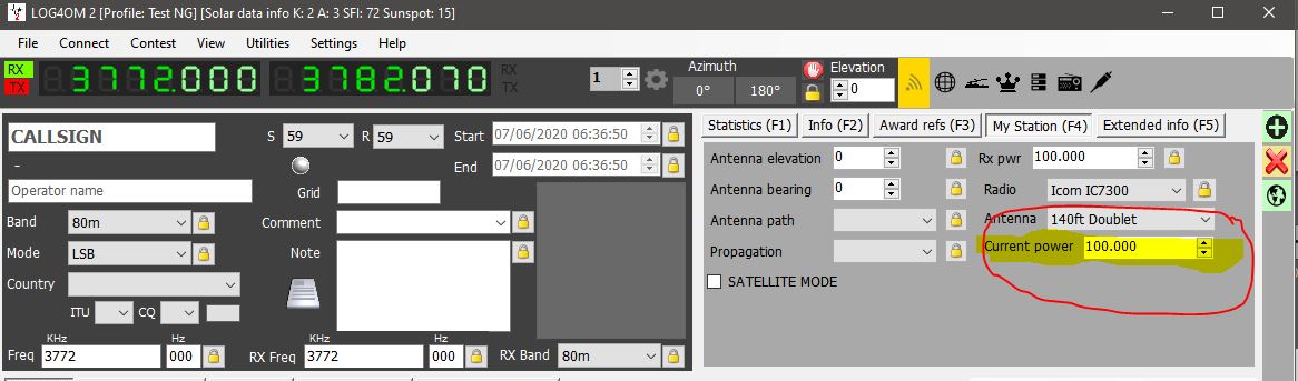

Re: Power Transfer
What have you set here?

When you press the Log QSO button in WSJT-X, the box that pops up has a space to enter the Tx power. This figure can be retained if wanted. If you use JTAlert, this power level is sent to Log4OM, and does override the level entered as the default in Logv4OM. I haven't tested with logging directly from WJT-X, so can't speak to that.
