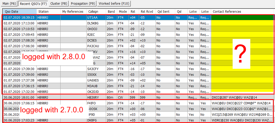

What I noticed when migrating from 2.7 to 2.8: Contact references (WAC, DXCC, WAZ etc.) for imported FT4/FT8 QSOs are no longer filled as they were in 2.7. Guess I messed up with a setting, but cannot find which one.

Thanks for your reply. Changed WSJT-X logging to UDP following manual pages 165/166 and made an FT4 contact (highlighted in blue). Result stays the same: Contact references are missing since logging with 2.8.0.0, also the ITU/WAZ zones remain empty.

MarkusHB9BRJ wrote: 02 Jul 2020, 18:52 Hi Terry,
