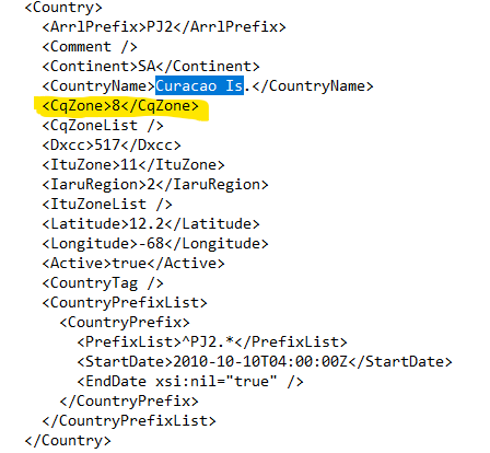

In the Country.xml file the CQ Zone for Curacao is wrong.
Instead of CQ Zone 8 it should be CQ Zone 9.
73 Dick DL1CLM

Can somebody tell me where to report an error in the country.xml file so that it can be edited.
On July 9th there is a new Country.xml file installed and there is still CQ Zone 8 for Curacao and this must be CQ Zone 9.
Thanks, Dick DL1CLM
Thanks, Dick DL1CLM

Hello Dick,
if nobody answeres try a mail to one of the team members like G4POP or IW3HMH. But you can edit
this file simply with an editor like Notepad++ and save it as Country_user.xml. That should work also
if a newer update of the Country.xml containing the wrong zone again. _user files will not be overwritten
by an update but they are overriding the original files.

Thanks Jürgen,
A few days ago I did indeed make a copy of Country.xml and made the adjustment in it.
Then saved it as Country_user.xml. just as it was in V1.
Strangely enough after a restart of Log4OM the wrong value kept coming (CQ Zone 8).
I had also assumed that Country_user.xml would be preferred but the value from Country.xml was displayed and not the value from Country_user.xml.
Do I need to put the custom file Country_user.xml in the directory 'user'? It is now in the same directory as Country.xml.
73 Dick DL1CLM
