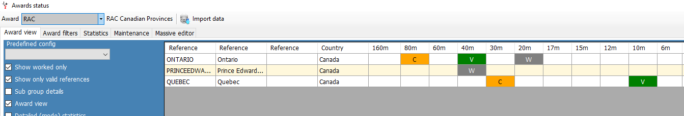

ok, i rescanned the log, and attached is a snippit of the result

Posts: 11571
Re: rac award showing only aboput 10 of 1300+ contacts
ve3wej wrote: 16 Aug 2020, 01:41 ok, i rescanned the log, and attached is a snippit of the result
Email me an ADIF file of your logbook
