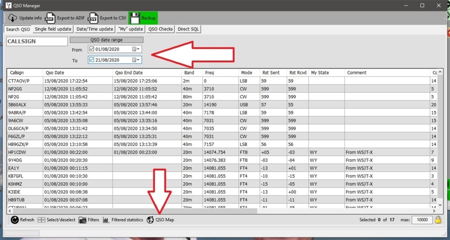

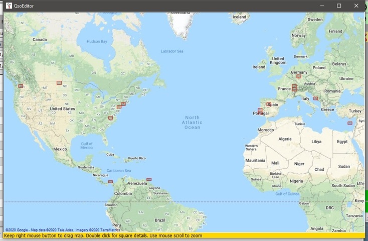

I'm a new user so forgive if i have missed the instructions for this...
Is there a way to view the day's QSO's on one of the maps, like PSK reporter does, sort of thing??
I'm still trying to figure out what features i need to use/enable, no idea what clusters are for etc so lots to learn :D
Re: Can this be done?
M7DJK wrote: 21 Aug 2020, 10:45 I'm a new user so forgive if i have missed the instructions for this...
Map 1.jpg (133.69 KiB) Viewed 4977 times
Then
Map 2.jpg (98.4 KiB) Viewed 4977 times

Ok, thanks that will do it :)
