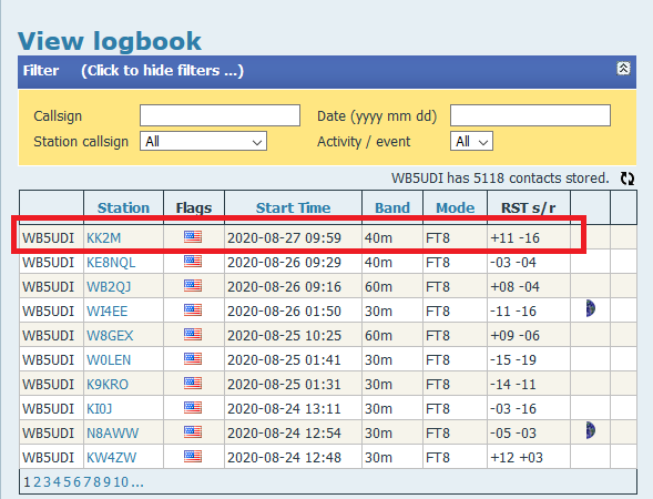

if i check your callsign at hrdlog.net and see your logbook it looks like the contact
was logged. Could be possible that there´s something wrong with the response from
hrdlog that Log4OM not get info that the QSL was received by HRDlog. Think the result
is that Log4OM don´t set hrdlog send to Y ...

Thanks, but what you are seeing is AFTER I had to manually force the upload in Log4OM, then Hrdlog.net shows the contact looged......so, the problem remains....but I appreciate you looking into this!
73's de Stan WB5UDI

O.K. you not wrote that you have uploaded manually after this 30 minutes, HI .... Have had a problem like
this in the past but only Log4OM have said No but the QSO´s was stored at hrdlog.net. This looks like another
problem. Hope Terry can help if he has checked your logfile ...
