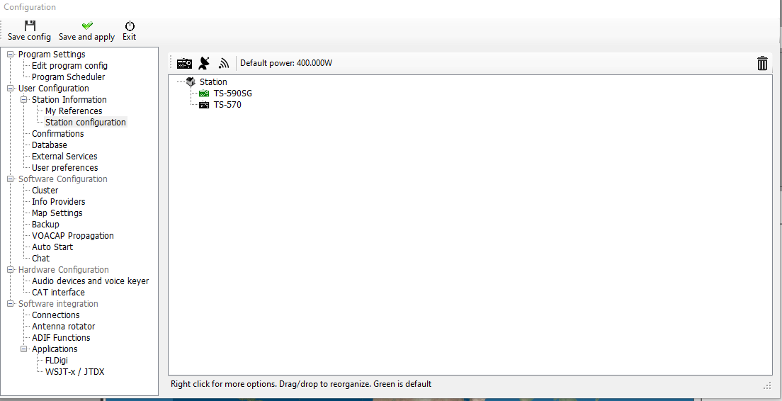

I read the manual that is linked to Log4om under the Help pulldown. The version I am using is 2.9.0.0. Attached is a screen shot of the Station Configuration page. There is no + symbol to click on or anything else to add another radio as shown in the manual.
Les
Les

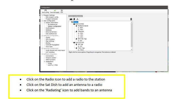

Les,
RE: "current" User Guide ... Did you do the "force download" of the User Guide. That will provide you with the "most current" version. Terry is constantly making changes and additions to the U.G. It is wise to check for that at least once each week. You can also save it to your local hard drive and search via you preferred PDF viewer. Check the front page of your U.G. and it should match what I noted in the post above unless Terry has already put up an update.
Now ... Page 171 has some text below the window for which you provided a clip for. There are 3 bullet points that tell you what to click on to add rigs, antennas and bands. Right clicking on certain elements will change the 'defaults' as you desire. That information is on Page 172 of the U.G. I noted above.
I've included the same clip as you did, but I enlarged it a tad to include 3 bullet points.
Best bet will be to open the U.G. and go to Pages 171-172 for your directions and look at the specific configuration at the same time and give it a go.
