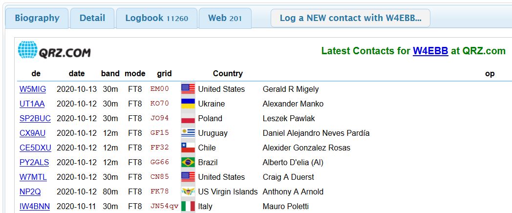

FYI - My QRZ Log shows band and frequency - see attachment

W4EBB wrote: 13 Oct 2020, 12:05 FYI - My QRZ Log shows band and frequency - see attachment
Charlie
W4EBB
Charlie,
Tnx. That poses an interesting question. I just did a view of your QRZ this AM (I did log in) and it only shows band to me.

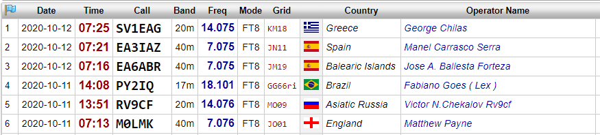

Shows frequency for me also, see below.
Did anyone think to ask ON4OM what Log4OM version he uses and what cat control (Hamlib or Omnirig)?

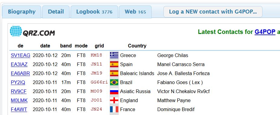

I have an old QRZ log in my profile and it also shows the frequency. That is just me looking at my own log.
I just choose to not display/use the QRZ log for day to day work.
When I view anyone else's log only the band shows up. I think that when looking at one's "own" log you get a different presentation of information.

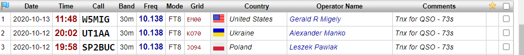

I think the user is saying that Log4OM is not sending the frequency to QRZ and clearly IT IS with the latest release as evidenced by my log record shown.
So I need to have clarified.....
1. What version of Log4OM and CAT control is the user using so that we can make sure we are reading from the same page.
2. Has the user checked that in his actual log on QRZ (select my logbook from menu) the frequencies are shown or not
