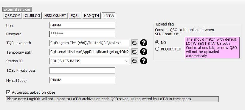

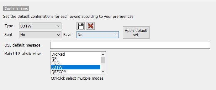

Hi
Following previous message which remained unanswered, here is the situation.
On both the confirmation configuration, and the external services, I have configured the LoTW sent field to NO.
See the 2 pictures attached.
The upload upon exit is not done, despite the little message saying it is.
When I changed both to "Requested", it seams to work.
Is it normal that it does not work when both are set to "NO" ?
Thanks + 73
