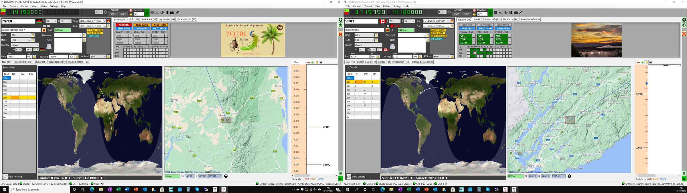

- Posts: 11603
Re: Portable version
Left instance is Portable connected to Elecraft - Right is Installed version running IC7300 - Two instances at same time
I use dual monitors
I use dual monitors
