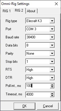

since weeks fighting with setup ( V2 ) and still Cannot persuade CAT to work .
system on W10 , rig K3 and Omnirig ( hamrig same problem )
73 gerd
Re: Log4OM v2 - Installation Questions
What exactly is your problem I have a K3 using Omnirig and Log4OM working perfectly under Windows 10!
